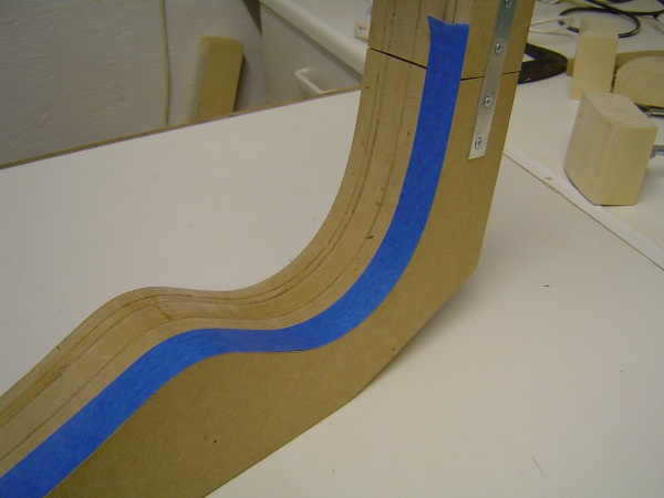

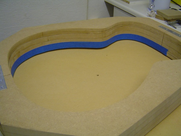

First thing to do is run a piece of low tack tape accurately onto the edge of the mould.
Place the mould into your 15' radius dish, tape towards the dish.

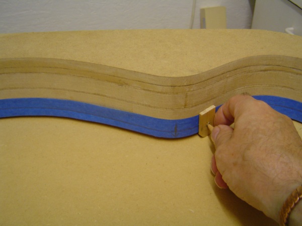

Drill a hole in a scrap piece of wood, round the end off, with a pencil pushed through the hole, run this around the radius dish marking the profile onto the tape.

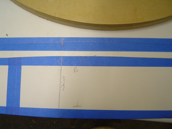

Make sure that you mark the waist and the bottom edge and also the join at head and tail.

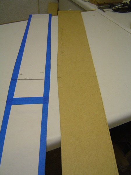

Remove the tape this will now have the profile of the back edge of the side on it. I then stick this tape onto heavy paper and cut to the line giving me a paper template. I also do this for the top profile so that I have a paper template of the final side shape with the top edge perpendicular to the ends and with the the back profile having the correct taper.
Use this paper template to cut a solid template from hardboard, MDF, whatever you like. This is then used to mark the side and cutting the profile before bending. Don't forget to also transfer the waist reference mark.

Joe, to get the side taper, first draw a line the length of your side on the paper, then at right angles at the ends put lines to the height of head and tail. Then when you put your tape onto the paper, connect the lines together. (Make sure you have the waist towards the head end!) You then have a profile of the back with the right taper as well. I then add the top profile to this, again connecting the end of the lines, the waist will be higher than the head end.
Tracy, you can use a washer, the problem is finding a washer with a large enough diameter but with a small enough centre hole to accurately position the pencil, I always round off the end of the wood so that I have a single contact point with the dish. Make sure if your dish is sandpaper covered that you put some paper on it or you'll sand away the wood!
The advantage of making your own profile is that it will be accurate for your radius dish, I make my own so dish so I don't gaurantee that it is accurately 15'.

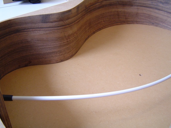

PostPosted: Wed Aug 23, 2006 12:10 am

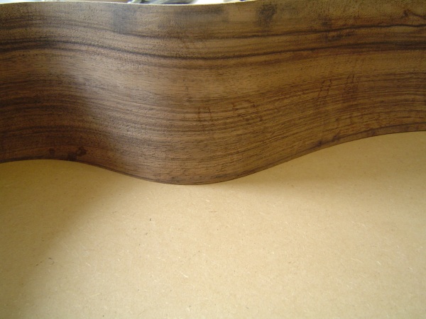

Last night I profiled an orphan walnut side using this template and bent it on my bender. As you can see the fit is pretty good before any sanding, in fact, its ready for the kerfing to be attached.
PostPosted: Wed Aug 23, 2006 12:15 am
Colin, that's impressive! Thanks for the tutorial and the pics of how well it works!
